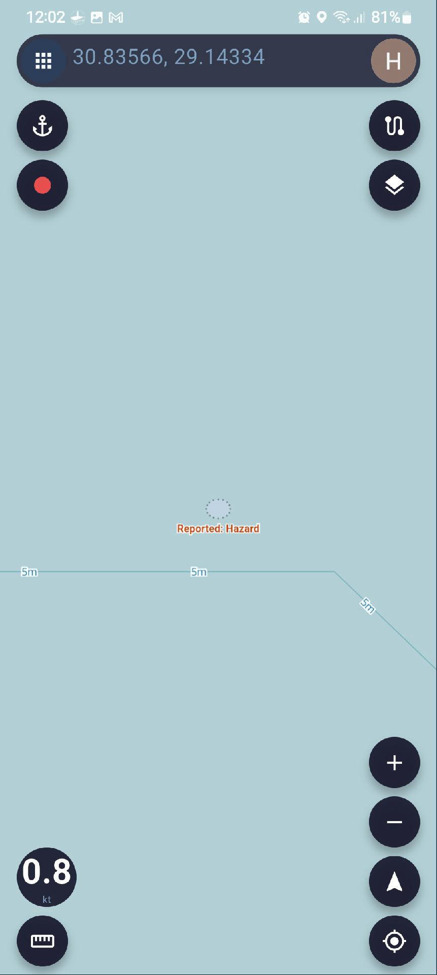

The reported hazard appears on the map as a small circle titled reported hazard (see screen shot) pressing the circle opens s small window at the bottom of the screen saying reported hazard with 2 buttons to confirm or reject The window only stays open 2-3 seconds and disappears before I can take screenshot

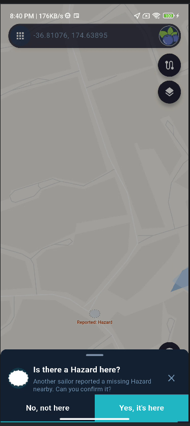

I tested this on several devices but wasn’t able to reproduce the 2–3 second automatic closing you described. I did find that the FacilityVotePromptCard is currently designed to close automatically after 60 seconds, so technically it does not remain open indefinitely until the user dismisses it. However, there is no 2–3 second timeout in the code. If the panel is closing that quickly, it may be caused by another dismissal path, for example: * Tapping or touching an empty area of the map clears the prompt. * Tapping outside the bottom panel can dismiss it. * Swiping the panel downward can also close it. I’ll keep investigating this behavior.
