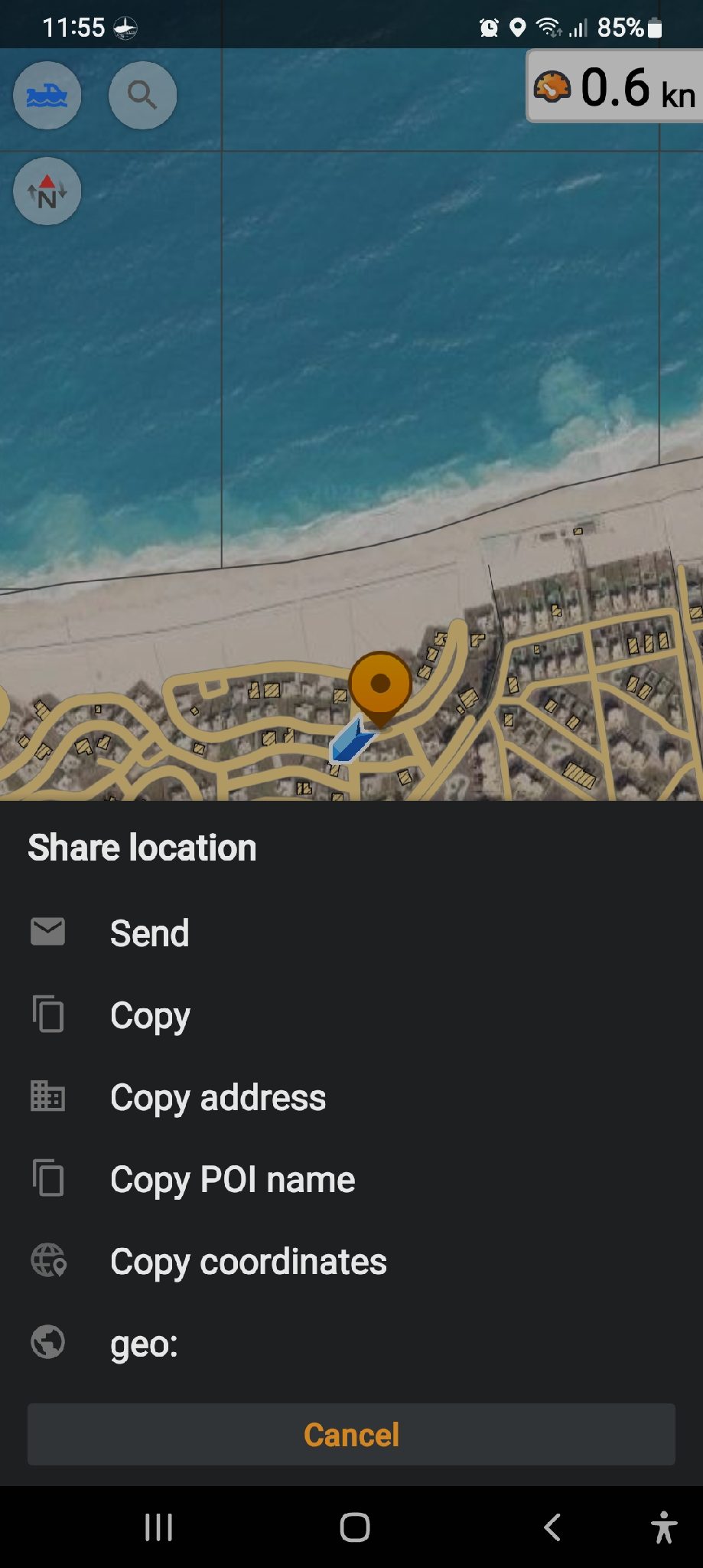

Thank you for the response This should work for seachart users but would exclude other navigation apps Perhaps you could consider offer link format options 1 share as seachart link 2 share as Google maps link 3 share geo. 4 share coordinates please see attached from Osmand The objective is to make position sharing as flexible and usefull to as many people as possible Thank you again Have a lovely day
